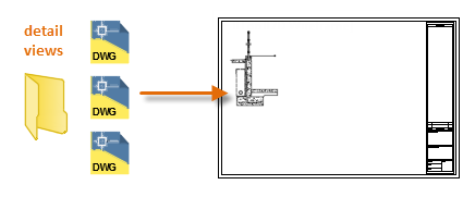

- Any drawing file. For example, you might create a drawing of a standard detail view. You can then use a block insertion tool to insert this drawing as a block into your current drawing. In this example, the detail views folder is commonly termed a
block library folder.

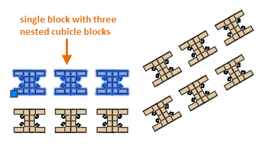

current drawing. For example, you might want to create a block from a set of objects that appear repeatedly in that drawing, such as the following cubicle arrangement that contains multiple
nested blocks. All the blocks used in the cubicle arrangement can be combined into a
single block for multiple placements.

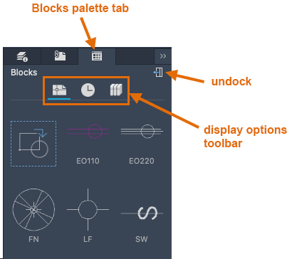

The Blocks palette is used to insert blocks.
- Click
This opens the Blocks palette and makes it active. By default it is docked on the right-side of the application.
Display Options Toolbar
Displays the blocks in the current drawing.
Displays recently inserted or created blocks. The recent list persists across drawings and sessions.
Displays the blocks from a selected block library.

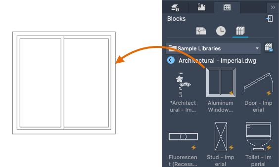

- Select the display option for block libraries.
- Do one of the following:
- Click the file drop-down list to display the 10 most recently used block libraries (folder or drawing file).
- Click to select a folder or a file.
Note: To share block libraries across AutoCAD platforms, sign in to your Autodesk account and select a folder or drawing from a cloud drive. - If you have selected a folder that contains multiple drawings, you can double-click on a drawing to view and insert the blocks in the drawing.
Note: Click Back to Library to return to the library and display the blocks and drawing in the folder.
- From the Blocks palette, double-click to place the block, or drag to place it. When you double-click to place the block you can use object snaps for more precision.

Create a Drawing for Use as a Block
Often, individual drawing files are created to be used as blocks and saved in a folder with similar drawing files. This method is an alternative to accessing the block definitions stored in a single drawing.
When you create a drawing file for use as a block, make sure that you locate an object at the origin point (0,0). This will serve as the default base point of the block. Later, when you insert the block, it is attached to your cursor at the base point.
In the following example, a drawing file is inserted into the current drawing to provide a standard detail view.
