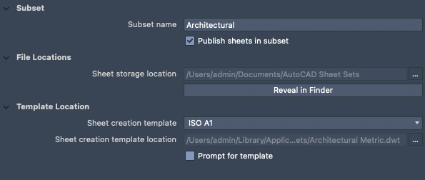

Displays information that is specific to the selected subset.
SHEETSET (Command)
Menu: : Select a subset in Sheet Set Manager
List of Options
The following options are displayed.
Subset
Displays the name and if the subset is included when publishing.
- Subset Name
- Displays the name of the subset.
- Publish Sheets in Subset
- Controls whether the sheets in the subset are added to the Batch Publish dialog box when publishing the subset or all sheets in the sheet set.
File Locations
Displays information about the folder on disk that the subset represents in the sheet set.
- Sheet Storage Location
- Specifies the folder location for new drawing (DWG) files created as a result of adding a new sheet to the subset.
- Does not impact the folder location of a drawing (DWG) file when adding sheets from an existing drawing.
- Reveal in Finder
- Displays the resolved absolute path to the folder on disk that the subset represents.
Template Location
Displays settings used when creating a new sheet in the subset.
- Sheet Creation Template
- Displays the layout to use when creating a new sheet.
- The layouts displayed in the drop-down list come from the file specified in the Default Template property.
- Sheet Creation Template Location
- Specifies the drawing template (DWT) or drawing (DWG) file to use when creating new drawing files for the subset.
- Prompt for Template
- Controls whether the New Sheet dialog box is displayed in the expanded or collapsed state each time a new sheet is added.
