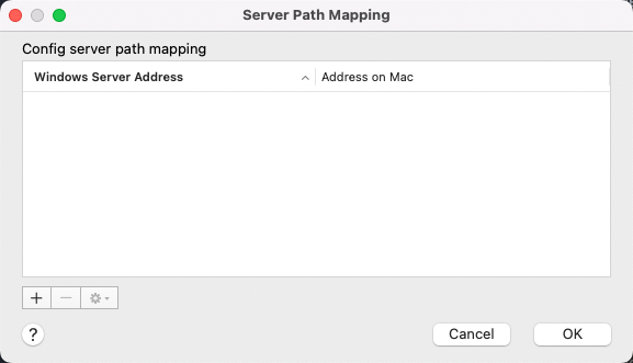

  4. Click the Mac and Windows server path mapping option.
  5. The Server Path Mapping dialog box appears.
  6. Click the + button.

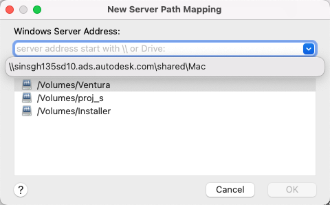

  7. The New Server Path Mapping dialog appears.
  8. Click the dropdown menu to find the Windows path of the missing xref file and map it to shared address in Mac.
  9. Click OK and the reference file is now loaded.
