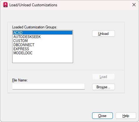

Load/Unload Customizations Dialog Box
Controls the display of customization groups and interface elements.
CUILOAD (Command)
List of Options
The following options are displayed.
Loaded Customization Groups
Lists the currently loaded customization files.
File Name
Specifies the file to load when you choose Load. You can either enter the file name or choose Browse to display the Select Customization File dialog box (a standard file selection dialog box).
Unload
Unloads the customization group selected in the Customization Groups list.
Load
Loads the file specified under File Name.
Browse
Displays the Select Menu File dialog box (a standard file selection dialog box), in which you can select a menu file to load.
