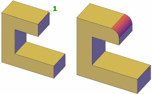

Rounds and fillets the edges of solid objects.
Find
You can select more than one edge. Enter a value for the fillet radius or click and drag the fillet grip.
The following prompts are displayed.
Select an Edge
Specifies one or more edges on the same solid body to fillet. After pressing Enter, you can drag the fillet grip to specify a radius, or use the Radius option.
Chain
Specifies more than one edge when the edges are tangent to one another.
Loop
Specifies a loop of edges on the face of a solid. For any edge, there are two possible loops. After selecting a loop edge you are prompted to Accept the current selection or choose the Next loop.
Radius
Specifies a radius value.
