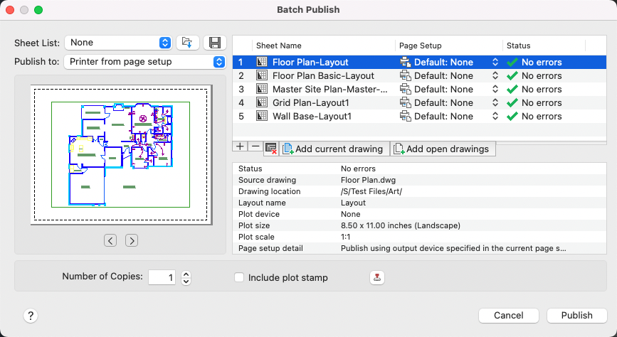

Batch Publish Dialog Box
Specifies drawing sheets that you can assemble, reorder, and publish as a multi-sheet drawing set.

Sheet List:
Displays the current drawing set (DSD) file.
Load Sheet List Button
Displays a standard file selection dialog box, in which you can select a DSD file to load. Displays the Replace or Append dialog box if a list of drawing sheets is present in the Batch Publish dialog box. You can either replace the existing list of drawing sheets with the new sheets or append the new sheets to the current list.
Save Sheet List Button
Displays the Save List As dialog box, in which you can save the current list of drawings as a DSD file. DSD files are used to describe lists of drawing files and selected lists of layouts within those drawing files.

Preview
Displays a preview of the selected layout in the Sheet list. Click the Next and Previous buttons to preview another layout in the Sheet list.
Sheets to Publish List
Contains the list of drawing sheets to be included for publishing. Click the page setup column to change the sheet’s settings. Use the shortcut menu and available buttons to add sheets or make other changes to the list.
Sheet Name
Combines the drawing name and the layout name with a dash (-). Drawing sheet names must be unique within a single PDF file.
Page Setup
Displays the named page setup for the sheet. You can change the page setup by clicking the page setup name and selecting another page setup from the list. Only Model page setups can be applied to Model sheets, and only named layout page setups can be applied to named layout sheets.
Status
Displays the status of the sheet when it is loaded to the list of sheets.
Manage Sheet List
Adds and removes layouts from the Sheet list.
Add Sheets (+)
Displays the Select Drawings dialog box (a standard file selection dialog box), in which you can select drawings to add to the list of sheets. The layout names from those files are extracted, and one sheet is added to the list for each Model and named layout in the drawing. You can use the Add Content list to specify to extract the Model layout only, named layouts only, or both.
The initial sheet names are constructed from the base drawing name and the layout name or the word Model separated by a dash (-).
Remove Sheets (-)
Deletes the selected sheets from the list.
Add Current Drawing
Adds the Model layout and all named layouts from the current drawing.
Add Open Drawings
Adds the Model layout and all named layouts from the drawings that are currently open.
Sheet List Shortcut Menu
The following options are available when you right-click a sheet:
Move to Top
Moves the selected sheets to the top of the list.
Move Up
Moves the selected sheets up one position in the list.
Move Down
Moves the selected sheets down one position in the list.
Move to Bottom
Moves the selected sheets to the bottom of the list.
Sheet Details
Displays the following information about the selected sheet: status, source drawing, drawing location, layout name, plot device, plot size, plot scale, and page setup details.
Printer from Page Setup Options
The following options are specific to publishing to a printer.
Number of Copies
Specifies the number of copies to publish.
