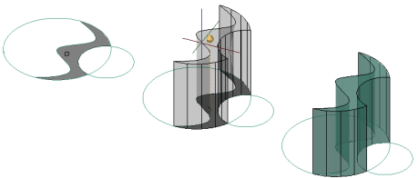

Create a Solid Object by Pressing or Pulling a Bounded Area
A bounded area is an area that contains no gaps. It can be formed by two or more overlapping objects.
  1. Click Modeling tab > Solid panel > Presspull.
  2. Click within any closed area that is bounded by coplanar objects or edges.
  3. Drag the mouse to establish an extrusion direction.
  4. Enter a value or click in the drawing area to indicate the extrusion distance.
