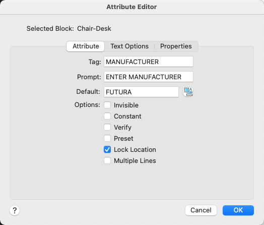

Attribute Tab (Attribute Editor Dialog Box)
Defines how a value is assigned to an attribute and whether or not the assigned value is visible in the drawing area, and sets the string that prompts users to enter a value. The Attribute tab also displays the tag name that identifies the attribute.
Tag
Sets the identifier assigned to the attribute.
Prompt
Sets the text for the prompt that is displayed when you insert the block.
Default
Sets the default value assigned to the attribute when you insert the block.
Options
Mode options determine whether and how attribute text appears.
Invisible
Displays or hides the attribute in the drawing area. If selected, hides the attribute value in the drawing area. If cleared, displays the attribute value.
Constant
Identifies whether the attribute is set to its default value. You cannot change this property. If a check mark is shown in the check box, the attribute is set to its default value and cannot be changed. If the check box is empty, you can assign a value to the attribute.
Verify
Turns value verification on and off. If selected, prompts you to verify the values you assign to the attribute when inserting a new instance of the block. If this option is cleared, verification is not performed.
Preset
Turns default value assignment on and off. If selected, sets the attribute to its default value when the block is inserted. If cleared, ignores the attribute's default value and prompts you to enter a value when inserting the block.
Lock Location
Locks the location of the attribute within the block reference. When unlocked, the attribute can be moved relative to the rest of the block using grip editing, and multiline attributes can be resized.
Multiple Lines
Indicates whether the attribute was defined as a Multiple Lines attribute and can contain multiple lines of text.

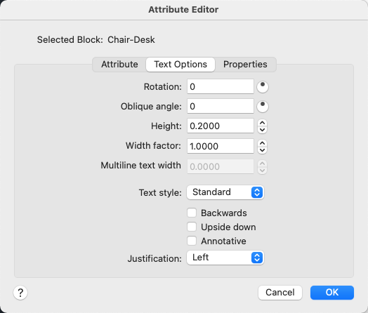

Text Options Tab (Attribute Editor Dialog Box)
Sets the properties that define the way an attribute's text is displayed in the drawing. Change the color of attribute text on the Properties tab.
Rotation
Specifies the rotation angle of the attribute text.
Oblique Angle
Specifies the angle that attribute text is slanted away from its vertical axis.
Height
Specifies the height of the attribute text.
Width Factor
Sets the character spacing for attribute text. Entering a value less than 1.0 condenses the text. Entering a value greater than 1.0 expands it.
Multiline Text Width
Specifies the maximum length of the lines of text in a multiple-line attribute before wrapping to the next line. A value of 0.000 means that there is no restriction on the length of a line of text. Not available for single-line attributes.
Text Style
Specifies the text style for attribute text. Default values for this text style are assigned to the text properties displayed in this dialog box.
Backwards
Specifies whether or not the text is displayed backwards.
Upside Down
Specifies whether or not the text is displayed upside down.
Annotative
Specifies that the attribute is annotative.
Justification
Specifies how attribute text is justified.
