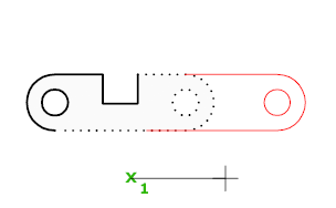

Objects that are partially enclosed by a crossing window are stretched. Objects that are completely enclosed within the crossing window, or that are selected individually, are moved rather than stretched. Some types of objects such as circles, ellipses, and blocks, cannot be stretched.
The following prompts are displayed.
Select objects
Specifies the portion of the object that you want to stretch. Use the cpolygon option or the crossing object selection method. Press Enter when the selection is complete.
STRETCH moves only the vertices and endpoints that lie inside the crossing selection, leaving those outside unchanged. STRETCH does not modify 3D solids, polyline width, tangent, or curve-fitting information.
