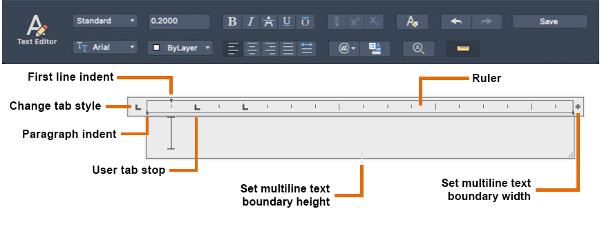

The In-Place Text Editor includes
- Text Editor visor
- Paragraph dialog box
- Column Settings dialog box
- Background Mask dialog box
- Columns menu
When a table cell is selected for editing, the In-Place Text Editor displays column letters and row numbers.
