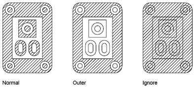

The three island detection styles are compared below:

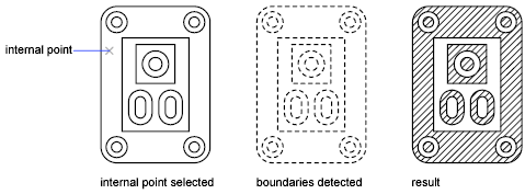

Using Normal island detection, if you specify the internal pick point shown, islands remain unhatched and islands within islands are hatched.
Using the same pick point, the results of the options are compared below.
Note: Text objects are treated as islands. If island detection is turned on, the result always leaves a rectangular space around the text.
