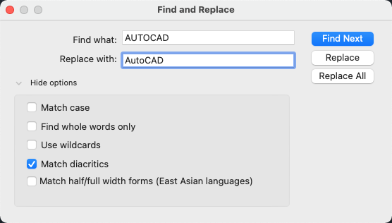

Find and Replace Dialog Box - MTEXT
Searches for specified text strings and replaces them with new text.
MTEXT (Command)
Tool Set: Drafting tab > Text panel > Multiline Text : Text Editor visor > Find and Replace .
List of Options
The following options are displayed.
Find What
Provides a space for you to type the text you want to find.
Replace With
Provides a space for you to type the text you want to replace the text you typed in Find What.
Find Next
Finds the next instance of the text specified in Find What.
Replace
Finds the next instance of the text specified in Find What and replaces it with the text in Replace With.
Replace All
Finds all instances of the text specified in Find What and replaces it with the text in Replace With.
Hide Options
Specifies advanced find options.
Match Case
Finds only text with uppercase and lowercase characters as specified in Find What.
The case of all characters in the text string must match the case of the text in Find What. When this option is cleared, a match is found for specified text strings regardless of case.
Match Whole Word Only
Finds only whole words specified in Find What.
Text that is part of another word is ignored. When this option is cleared, a match is found for text strings, whether they are single words or parts of other words.
Use Wildcards
Allows the use of wildcard characters in searches.
Match Diacritics
Matches diacritical marks, or accents, in search results.
Match Half/Full Width Forms (East Asian Languages)
Matches half- and full-width characters in search results.
