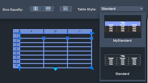

To Apply a New Table Style to a Table
Table Visor
  1. Click a gridline on the table to select the table.
    The Table visor displays thumbnails for each table style.
  2. Select a table style.
    The table style is applied to the table.
Properties Inspector
  2. If the Properties Inspector isn't open, click Window menu > Properties Inspector.
  3. On the Properties Inspector, select a table style from the Table Style drop-down in the Table section.
Context Menu
  2. Right-click and select Table Style.
  3. On the Table Style flyout, select a table style from the list.
