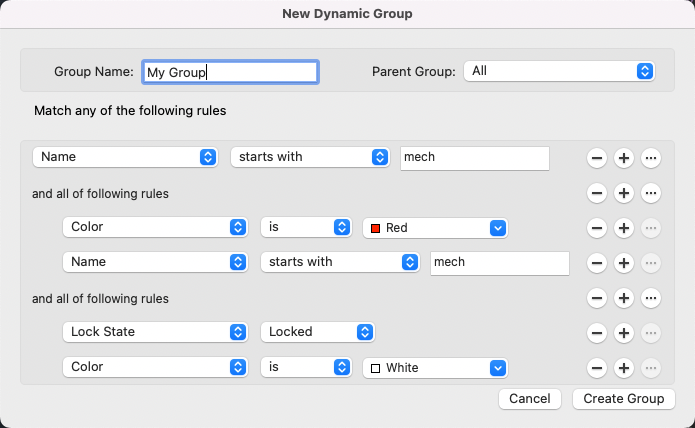

Create a Layer Group Based on Layer Properties
  1. In the Layers palette, click New Dynamic Layer Group.
  2. In the New Dynamic Group dialog, enter a name for the group.
  3. Specify the rules as follows:
    • To group by Name, select Name, the match criteria, and enter the match value.
    • To group by property, select the property and the property state.
    • To group using logical AND rules, click .
    • To group using logical OR rules, click
In this example, the dynamic layer group includes:
  • Layers that start with "mech" AND are red
    OR
  • Layers that start with "mech" AND are locked AND are white
