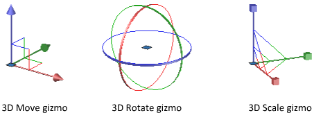

There are three types of gizmos:
  • 3D Move gizmo. Relocates selected objects along an axis or plane.
  • 3D Rotate gizmo. Rotates selected objects about a specified axis.
  • 3D Scale gizmo. Scales selected objects along a specified plane or axis, or uniformly along all 3 axes.

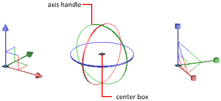

Gizmos are available only in 3D views that are set to use a 3D visual style such as Hidden. You can set the gizmo to be displayed automatically when you select a 3D object or subobject. Gizmos are also displayed during the 3D Move, 3D Rotate, and 3D Scale operations.
By default, the gizmo is initially placed in the center of the selection set. However, you can relocate it anywhere in 3D space. The center box (or base grip) of the gizmo sets the base point for the modification. This behavior is equivalent to temporarily changing the position of the UCS as you move or rotate the selected objects. The axis handles on the gizmo constrain the movement or rotation to an axis or plane.
