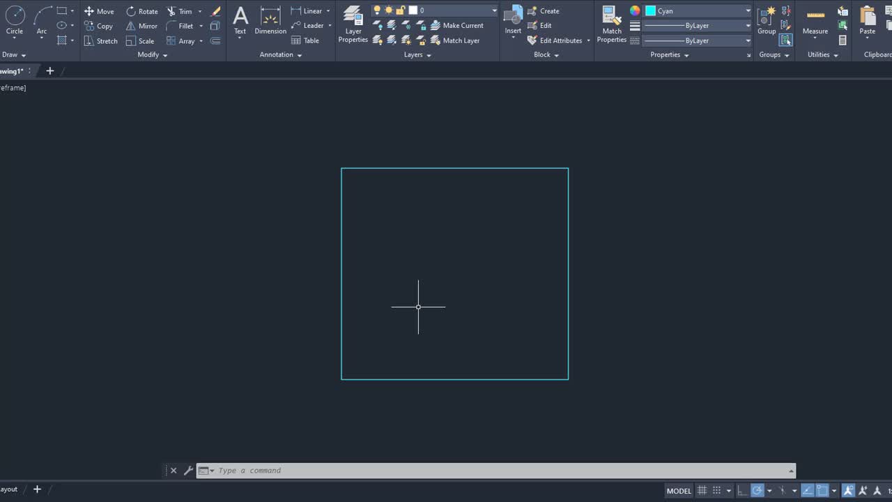

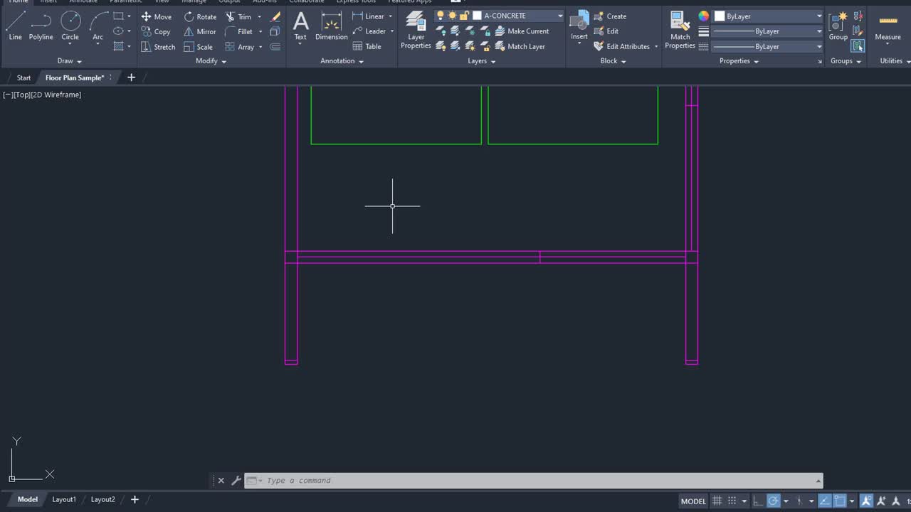

  1. Click Manage tab > Cleanup panel > Overkill. Find
  2. Enter "all" at the Command prompt to add all objects in the drawing to the selection set.
    The Delete Duplicate Objects dialog box opens. For now, let's use the default options.
  3. Click OK.
This drawing looks the same as it did before. Even though none of the untidiness was visible, 30 duplicate objects and 2,387 overlapping objects and line segments were deleted.

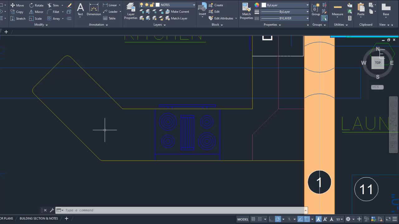

Ignore Object Property
By default, OVERKILL doesn't act on objects that have differentiating properties. For example, if objects are identical but are on a different layer or have a different lineweight, those objects will not be treated as duplicate. However, you can change the settings to ignore certain properties.
In this example, there are three identical line segments, except they are each assigned a different color. Selecting the Color option will remove all duplicate objects.
The following object properties can be ignored during comparison:
  • Color
  • Layer
  • Linetype
  • Linetype scale
  • Lineweight
  • Thickness
  • Transparency
  • Plot style
  • Material
Optimize Segments Within Polylines
In this example, a line is overlapping a polyline. If Optimize Segments within Polylines is selected, using OVERKILL on these objects deletes the line object.
Combine Co-linear Objects When Aligned End to End
With this option selected, line segments that are aligned end to end will be joined to create a single line.
