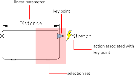

Actions define how the geometry of a dynamic block reference will move or change when its grips are manipulated.
In general, you associate an action with a parameter and the following:
  • Key point . The point on a parameter that drives the action.
  • Selection set . The geometry that will be affected by the action.
When you move the grip in the example above, only the geometry in the selection set is stretched.
