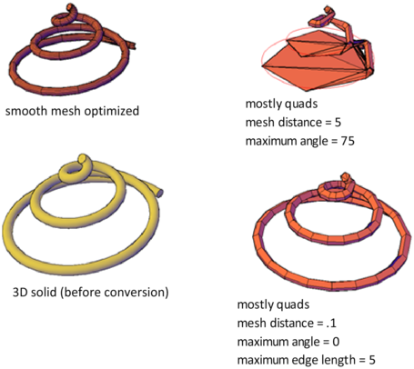

For example, if the smooth mesh optimized mesh type (FACETERMESHTYPE system variable) results in incorrect conversions, you can set the tessellation shape to be Triangle or Mostly Quads.
You also can control the adherence to the original shape by setting the maximum distance offset, angles, aspect ratios, and edge lengths for new faces. The following example shows a 3D solid helix that has been converted to a mesh using different tessellation settings. The optimized mesh version has been smoothed, but the other two conversions have no smoothness. Notice, however, that the mostly quads conversion with the lower tessellation values creates a mesh object that adheres most closely to the original version. Smoothing this object improves its appearance even more.
Similarly, if you notice that a converted mesh object has a number of long, slivered faces (which can sometimes cause gaps), try decreasing the maximum edge length for new faces value (FACETERMAXEDGELENGTH system variable). If you are converting primitive solid objects, this dialog box also offers the option of using the same default settings used to create primitive mesh objects.
