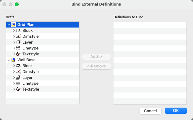

Bind External Definitions Dialog Box
Adds xref-dependent named objects (such as blocks, dimension styles, layers, linetypes, and text styles) to your drawing.
XBIND (Command)
Menu: Modify > Object > External Reference > Bind.
List of Options
The following options are displayed.
Xrefs
Lists the xrefs currently attached to the drawing. Selecting an xref (double-clicking) displays the named object definitions in the attached xref.
Definitions to Bind
Lists the xref-dependent named object definitions to bind to the host drawing.
Add
Moves the named object definitions selected in the Xrefs list into the Definitions to Bind list.
Remove
Moves the xref-dependent named object definition selected in the Definitions to Bind list back to its xref-dependent definition table.
