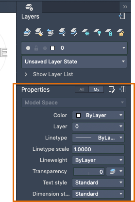

The Properties Inspector Palette
The Properties Inspector palette is an essential tool. By default, the Properties Inspector palette is docked on the right side below the Layers palette.
The Properties Inspector displays a list of all the important property settings. You can click any of the available fields to change the current settings. In the following example, if no objects are selected, the current color will be changed from ByLayer to Red. All subsequently created objects will then be assigned the color property Red.

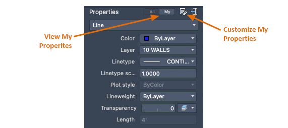

All or My Properties
You can switch the Properties Inspector to display all properties for the selected objects, or to display a personalized list of properties. Set up your personalized list of properties using the Customize My Properties button.

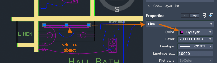

Verify and Change Object Properties
You can use the Properties Inspector palette to verify and change property settings for selected objects. If you click an object in your drawing to select it, here is what you might see in the Properties Inspector palette.
Notice that the current properties for the selected object are displayed in the palette. You can change any of these properties by clicking and changing the setting. A property that is set to "ByLayer" inherits its setting from the layer. In the previous example, the objects that were created on the 20 ELECTRICAL layer are purple because that is the default color of the objects on that layer.
If you select several objects, only their common properties are listed in the palette. If you change one of these properties, all the selected objects will change in one operation. Selecting objects is covered in more detail in the Modify topic.

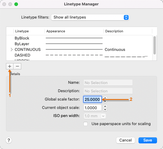

Linetypes
Dashed and other non-continuous linetypes are assigned from the Properties Inspector palette. You must first load a linetype before you can assign it.
From the Format menu, click Linetype. This action displays the Linetype Manager dialog box.
Perform the following steps:
- Click +. Choose one or more linetypes that you want to use. Notice that dashed (non-continuous) linetypes come in several preset sizes.
- Specify a different "global scale factor" for all linetypes—the larger the value, the longer the dashes and spaces. Click Save.
Once you've loaded the linetypes that you plan to use, you can select any object and specify a linetype from the Properties palette. Alternatively, you can specify a default linetype for any layer in the Layer Properties Manager.

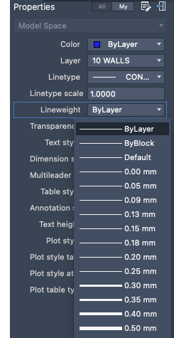

Lineweights
The Lineweight property provides a way to display different thicknesses for selected objects. The thickness of the lines remain constant regardless of the scale of the view. In a layout, lineweights display and print in real-world units.
You can leave the lineweight set to ByLayer, or you can specify a value that overrides the layer's lineweight. In some cases, the lineweight previews look the same because they are displayed in approximated pixel widths on a monitor.
To control the display of lineweights, use the LWDISPLAY system variable or toggle the Show/Hide Lineweights button on the status bar.
Regardless of how the lightweights appear on your monitor, objects always print at the lineweight you specify.
