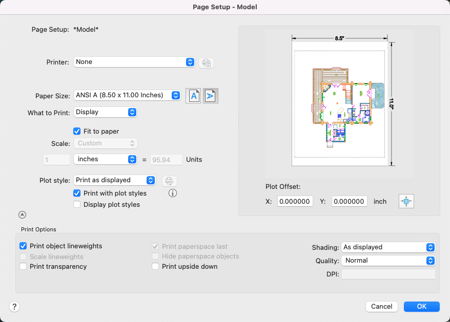

Page Setup Dialog Box
Specifies page layout and plotting device settings.

The Page Setup dialog box is displayed in the following cases:
  • When you create a new page setup through the Page Setup Manager
  • When you modify an existing page setup through the Page Setup Manager
  • When you edit a page setup using PAGESETUPEDIT
  • In the Quick View dialog box, when you right-click a layout and click Edit Page Setup
The page setup settings that you specify are stored with the layout and can be applied to other layouts or imported into other drawings.
Page Setup
Displays the name of the current page setup.
Printer
Specifies a configured plotting device to use when plotting layouts. Lists the available PC3 files or system printers from which you can select to plot the current layout.
If the selected plotter doesn't support the layout's selected paper size, a warning is displayed and you can select the plotter's default paper size or a custom paper size.
PDF Options or Printer Configuration
  • If PDF output is selected, displays the PDF Options dialog box, which gives you the ability to optimize a PDF file for the specific purpose you are creating it.
  • If a printer is selected, displays the Print dialog box where you can choose the printer settings. Printer settings are saved in a .pc3 file which can be selected the next time you plot.
Paper Size
Displays standard paper sizes that are available for the selected plotting device. If no plotter is selected, the full standard paper size list is displayed and available for selection.
If the selected plotter doesn't support the layout's selected paper size, a warning is displayed, and you can select the plotter's default paper size or a custom paper size.
A default paper size is set for the plotting device when you create a PC3 file with the Add-a-Plotter wizard. The paper size that you select in the Page Setup dialog box is saved with the layout and overrides the PC3 file settings.

Preview (Area)
A preview area is available making it easy to see how your drawing will appear when plotted.

Print Options
Print Object Lineweights
Specifies whether lineweights assigned to objects and layers are plotted.
Scale Lineweights
Scales lineweights in proportion to the plot scale. Lineweights normally specify the linewidth of plotted objects and are plotted with the linewidth size regardless of the plot scale.
Print Transparency
Specifies whether object transparency is plotted. This option should only be used when plotting drawings with transparent objects.
Attention: For performance reasons, plotting transparency is disabled by default. This setting can be overridden by the PLOTTRANSPARENCYOVERRIDE system variable. By default, the system variable honors the setting in the Page Setup and the Plot dialog boxes.
Print Paperspace Last
Plots model space geometry first. Paper space geometry is usually plotted before model space geometry.
Hide Paperspace Objects
Specifies whether the HIDE operation applies to objects in the paper space viewport. This option is available only from a layout tab. The effect of this setting is reflected in the plot preview, but not in the layout.
Print Upside Down
Orients and plots the drawing upside down.
Shading
Specifies how views are plotted. To specify this setting for a viewport on a layout tab, select the viewport, right-click and then, click Properties.
From the Model tab, you can select from the following options:
  • As Displayed. Plots objects the way they are displayed on the screen. (Available in AutoCAD LT)
  • Legacy Wireframe. Objects in wireframe regardless of the way they are displayed on the screen, using the legacy SHADEMODE command. (Available in AutoCAD LT)
  • Legacy Hidden. Objects with hidden lines removed regardless of the way the objects are displayed on the screen, using the legacy SHADEMODE command. (Available in AutoCAD LT)
  • Conceptual. Plots objects with the Conceptual visual style applied regardless of the way the objects are displayed on the screen.
  • Hidden. Plots objects with hidden lines removed regardless of the way the objects are displayed on the screen.
  • Realistic. Plots objects with the Realistic visual style applied regardless of the way the objects are displayed on the screen.
  • Shaded. Plots objects with Shaded visual style applied regardless of the way the objects are displayed on the screen
  • Shaded with Edges. Plots objects with Shaded with Edges visual style applied regardless of the way the objects are displayed on the screen
  • Shades of Gray. Plots objects with Shades of Gray visual style applied regardless of the way the objects are displayed on the screen.
  • Sketchy. Plots objects with Sketchy visual style applied regardless of the way the objects are displayed on the screen.
  • Wireframe. Plots objects in wireframe regardless of the way they are displayed on the screen.
  • X-ray. Plots objects with x-ray visual style applied regardless of the way the objects are displayed on the screen
  • Rendered. Plots objects as rendered regardless of the way they are displayed on the screen.
Quality
Specifies the resolution at which shaded viewports are plotted.
You can select from the following resolution options:
  • Draft. Sets rendered and shaded model space views to be plotted as wireframe.
  • Preview. Sets rendered and shaded model space views to be plotted at one quarter of the current device resolution, to a maximum of 150 dpi.
  • Normal. Sets rendered and shaded model space views to be plotted at one half of the current device resolution, to a maximum of 300 dpi.
  • Presentation. Sets rendered and shaded model space views to be plotted at the current device resolution, to a maximum of 600 dpi.
  • Maximum. Sets rendered and shaded model space views to be plotted at the current device resolution with no maximum.
  • Custom. Sets rendered and shaded model space views to be plotted at the resolution setting that you specify in the DPI box, up to the current device resolution.
DPI
Specifies the dots per inch for shaded views, up to the maximum resolution of the current plotting device. This option is available if you select Custom in the Quality box.
Note: DPI is disabled if no printer is selected.
