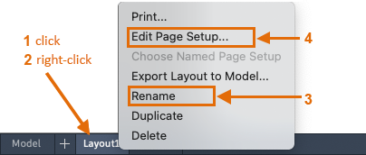

Specifying the Paper Size of a Layout
The first thing that you should do when you access a layout tab (1) is right-click the tab (2) and rename it (3) to something more specific than Layout 1. Names that reference a specific ANSI or ISO size might be a good choice.
Next, edit the page setup (4) to change the paper size displayed in the layout tab. There are a lot of controls here, but you only need to change a few. The first is to specify the size of your sheet.

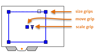

A layout viewport is an object that's created on a layout tab to display a scaled view of model space. You can think of it as a closed-circuit TV monitor that displays part of model space. You can select a layout viewport as you would any other object. When you select it, several grips display that provide a way to adjust the size of the viewport, move the viewport, and specify the scale of the view that's contained in it.
Several editing commands such as Move, Erase, and Copy can be used on layout viewports. When you select a layout viewport, you can use the Properties Inspector palette to provide a complete list of options and settings.

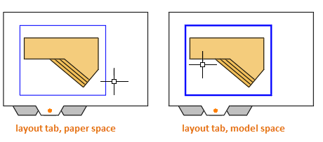

Switch between Model Space and Paper Space
When you're working on a layout tab, you can switch between paper space and model space without returning to the Model tab. Here's how. As shown in the illustration, you move your cursor and double-click either inside a layout viewport to access model space or you double-click outside the layout viewport to return to paper space. When you're in model space, the border of the layout viewport becomes thicker.
The primary reasons that you might want to access model space through the layout viewport is to pan the view or to make minor adjustments to the objects, especially those that display only in that viewport.

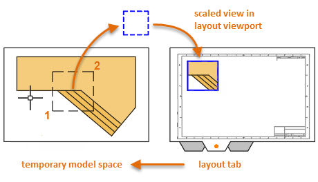

Create a New Viewport
You can use the New option of the MVIEW (make view) command to create additional layout viewports in paper space. With several layout viewports, you can display different views of model space at the same scale or at different scales.
- From a layout tab, enter MVIEW in the Command window and choose the New option.
- A maximized view of model space displays temporarily and you can click two points as shown to define an area.
- Back in the layout, right-click to display a list of scales and click the one that you want to use.
- Click a location to place the new layout viewport containing the scaled view.
If you later need to set a different scale, select the layout viewport and click the triangular scale grip. This action displays a list of scales to choose from.
By default, scaled viewports are automatically locked to prevent accidental zooming or panning, which would change the scale or the clipping boundaries. You can lock and unlock a layout viewport by selecting it, right-clicking to display the shortcut menu, and choose Display Locked > On or Off.

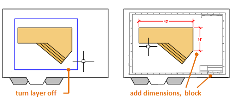

Trans-Spatial Annotation
After you create one or more scaled layout viewports on a layout tab, follow these steps to use the trans-spatial method of annotating your drawing:
- Move the layout viewport as needed, and adjust its edges using the size grips.
- Turn off the layer on which you created the layout viewport object. This hides the edges of the layout viewport.
- Create notes, labels, and dimensions directly in paper space. They automatically appear at the correct size.
- Print the drawing to paper or as a DWF or PDF file.
