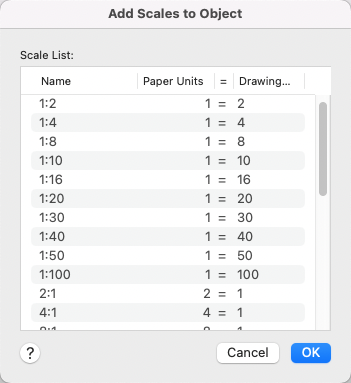

Add Scales to Object Dialog Box
Adds a new scale to the selected annotative object.
OBJECTSCALE (Command)
Menu: Modify > Annotative Object Scale > Add/Delete Scales > Select annotative object > .
List of Options
The following option is displayed.
Scale List
Displays the list of scales that can be added to the selected annotative object.
Multiple scales can be selected by holding down the Shift or Command key while selecting the scales.
Use the SCALELISTEDIT command to add custom scales to this list.
