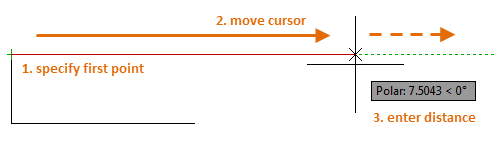

Polar Tracking
When you need to specify a point, such as when you create a line, you can use polar tracking to guide the movement of your cursor in certain directions.
For example, after you specify the first point of the line below, move your cursor to the right, and then enter a distance in the Command window to specify a precise horizontal length for the line.
By default, polar tracking is turned on and guides your cursor in a horizontal or vertical direction (0 or 90 degrees).
To turn polar tracking on and off, press F10 or
on the touch bar.

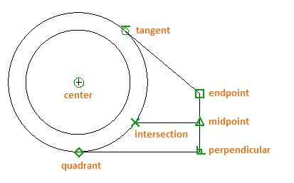

Object Snaps
By far, the most important way for you to specify precise locations on objects is to use object snaps. In the following illustration, several different kinds of object snaps are represented by markers.
Object snaps become available during a command whenever AutoCAD prompts you to specify a point. For example, if you start a new line and move your cursor near the endpoint of an existing line, the cursor will automatically snap to it.
To turn object snaps on and off, press F3 or
on the touch bar.

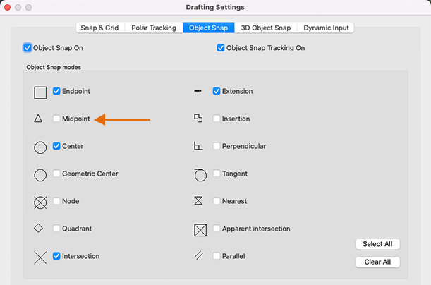

Set Default Object Snaps
Enter the OSNAP command to set the default object snaps, which are also called "running" object snaps. For example, you might find it useful to turn on the Midpoint object snap by default.

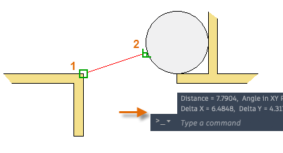

Verify Your Work
Recheck your geometry to catch mistakes early. Enter the DIST command (or just DI) to measure the distance between any two points in your model.
For example, you might need to find the clearance between two points shown, which might represent the corner of a wall and a small table, or perhaps a 2D section of a plastic part and a wire.
After you enter DIST, click the endpoint on the corner (1). Next, hold down Shift as you right-click, and then choose Perpendicular from the object snap menu. Finally, click the circle (2).
The number of decimal places and unit style displayed in the result is controlled by the UNITS command.
