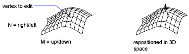

Edit Vertex
Edits individual vertices of a polygon mesh that can be seen as a rectangular M by N array, where M and N are the dimensions specified in 3DMESH. The SURFTAB1 and SURFTAB2 system variables store M and N values for RULESURF, TABSURF, REVSURF, and EDGESURF.
Pressing Enter accepts the current default, which is either Next or Previous.
Next
Moves the X marker to the next vertex. The marker does not wrap around from the end to the start of the mesh, even if the mesh is closed.
Previous
Moves the X marker to the previous vertex. The marker does not wrap around from the start to the end of the mesh, even if the mesh is closed.
Left
Moves the X marker to the previous vertex in the N direction. The marker does not wrap around from the start to the end of the mesh, even if the mesh is closed.
Right
Moves the X marker to the next vertex in the N direction. The marker does not wrap around from the end to the start of the mesh, even if the mesh is closed.
Up
Moves the X marker to the next vertex in the M direction. The marker does not wrap around from the end to the start of the mesh, even if the mesh is closed.
Down
Moves the X marker to the previous vertex in the M direction. The marker does not wrap around from the start to the end of the mesh, even if the mesh is closed.
Move
Repositions the vertex and moves the editing mark.
Regen
Regenerates the polygon mesh.
Exit
Exits Edit Vertex mode.

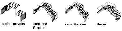

Smooth Surface
Fits a smooth surface. The SURFTYPE system variable controls the type of surface this option fits. The types of surfaces include quadratic B-spline, cubic B-spline, and Bezier.
Desmooth
Restores the original control-point polygon mesh.
