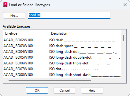

Load or Reload Linetypes Dialog Box
Loads a linetype whose definition exists in a linetype library (LIN) file.
LINETYPE (Command) Find: Load
The following files contain the standard linetypes:
  • AutoCAD: acad.lin
  • AutoCAD LT: acadlt.lin
List of Options
The following options are displayed.
File Button
Displays the Select Linetype File dialog box, in which you can select a different linetype (LIN) file.
File Name
Displays the name of the current LIN file. You can enter the name of another LIN file or click the File button to select a file from the Select Linetype File dialog box.
Available Linetypes
Displays the linetypes available to load. To select or clear all of the linetypes on the list, right-click and choose Select All or Clear All.
