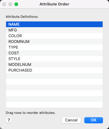

Attribute Order Dialog Box
Specifies the order in which attributes are listed and prompted for when you insert or edit a block reference.
BATTORDER (Command)
Note: This command is available only in the Block Editor (BEDIT).
List of Options
The following options are displayed.
Attribute Definitions
Lists the attribute definitions in the current block.
Drag an attribute definition up or down in the list to reorder it.
