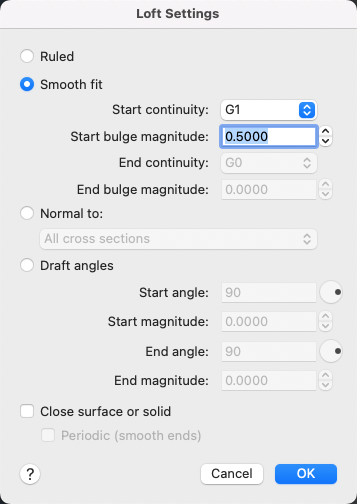

Loft Settings Dialog Box
Controls the contour of a lofted surface at its cross sections. Also allows you to close the surface or solid.

List of Options
The following options are displayed.
Ruled
Specifies that the solid or surface is ruled (straight) between the cross sections and has sharp edges at the cross sections. (LOFTNORMALS system variable)
Smooth Fit
Specifies that a smooth solid or surface is drawn between the cross sections and has sharp edges at the start and end cross sections. (LOFTNORMALS system variable)
Start Continuity
Sets the tangency and curvature of the first cross section.
Start Bulge Magnitude
Sets the size of the curve of the first cross section.
End Continuity
Sets the tangency and curvature of the last cross section.
End Bulge Magnitude
Sets the size of the curve of the last cross section.
Normal To
Controls the surface normal of the solid or surface where it passes through the cross sections. (LOFTNORMALS system variable)
Start Cross Section
Specifies that the surface normal is normal to the start cross section.
End Cross Section
Specifies that the surface normal is normal to the end cross section.
Start and End Cross Sections
Specifies that the surface normal is normal to both the start and end cross sections.
All Cross Sections
Specifies that the surface normal is normal to all cross sections.

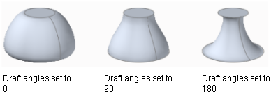

Draft Angles
Controls the draft angle and magnitude of the first and last cross sections of the lofted solid or surface. The draft angle is the beginning direction of the surface. 0 is defined as outward from the plane of the curve. (LOFTNORMALS system variable)
The following illustration shows the affect of using a different draft angle for the first and last cross sections of a lofted solid. The first cross section is assigned a draft angle of 45 degrees, while the last cross section is assigned a draft angle of 135 degrees.
You can also use the draft angle handle to adjust the draft angle (triangular grip) and magnitude (circular grip).

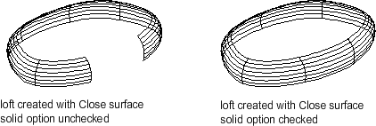

Close Surface or Solid
Closes and opens a surface or solid. When using this option, the cross sections should form a torus-shaped pattern so that the lofted surface or solid can form a closed tube. (LOFTPARAM system variable)
Periodic (Smooth Ends)
Creates a smooth, closed surface whose seam will not kink if it is reshaped. This option is only available if the loft is ruled or smooth fit and the Close Surface or solid option is selected.
