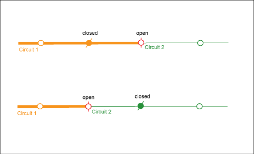

Use this maintenance workflow to transfer load from one circuit to another by opening one device and closing another. The two devices must be connected to two different circuits. Otherwise, it is not possible to start the workflow. The open device will break the two circuits. An open device has no circuit assigned (FID_Circuit attribute is not set).

Before you transfer load, be sure that the breakers selected are assigned to the circuits and are set as the Device Origin for the circuit.
  1. Start the Load Transfer workflow.
  2. In the Workflow pane, under Select Device To Open, click Choose and select the device in the map.
  3. Under Select Device To Close, click Choose and select the device in the map.
The workflow transfers the load, reconfigures the circuit and flow, and checks for phase inconsistencies. It runs the Reconfigure Circuit And Flow and the Reconfigure Phase workflows.
