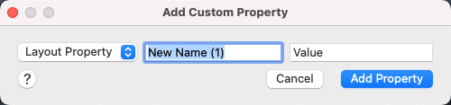

Creates a custom property to be associated with the current project or with each layout.
SHEETSET (Command)
Menu: : .
Note: If the Details section is not visible, click
List of Options
The following options are displayed.
Owner
Specifies whether the custom property will belong to the project or layout.
Name
Specifies the name of the new custom property.
Default Value
Specifies a value for the custom property.
