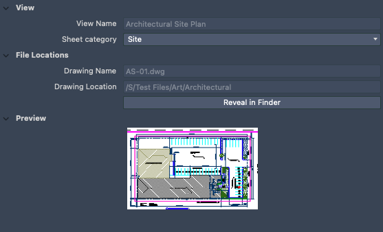

Summary
Views represent named views that have been placed on a sheet in the current sheet set using the Sheet Set Manager. Views cannot be modified or placed using the Sheet Set Manager.
List of Options
The following options are displayed.
View
Displays information about the view.
View Name
Displays the name of the view.
Sheet Category
Assigns a category to the view.
The category list is populated by the current value of each model space view's View Category property when it was placed on a sheet in the sheet set.
File Locations
Displays information about the drawing file that the view is located.
Drawing Name
Displays the name of the drawing that contains the named view.
Drawing Location
Displays the path of the drawing where the view is saved.
Reveal in Finder
Displays the location of the drawing (DWG) file associated with the view in Finder.
Preview
Displays a preview image of the selected view.
