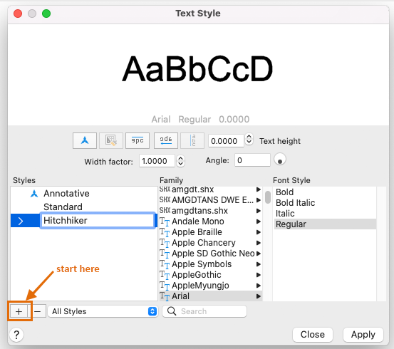

Create a Text Style
As with several other annotation features, multiline text provides a lot of settings. You can save these settings as a text style using the STYLE command, and then you can access the text styles you've saved by clicking the Text Style drop-down arrow on the Properties Inspector palette. The current text style is displayed on the Properties Inspector palette when no objects are selected.
To create a new text style, click the Text Style control on the Drafting toolset as shown.
When you create a new text style, you give it a name, and then choose a font and a font style.

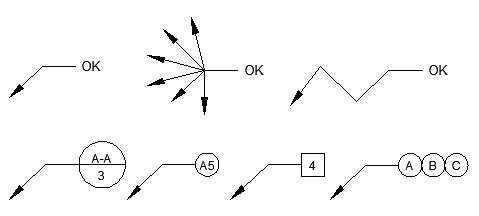

Multileaders
Multileader objects are used to create text with leader lines such as general labels, reference labels, bubbles, and callouts.
Create a Multileader
To create a multileader, use the MLEADER command. Click the Multileader tool in the Leader panel of the Drafting toolset
, or enter MLD in the Command window. Follow the prompts and options in the Command window. Feel free to experiment.
After you create a multileader, select it and then modify it by clicking and moving its grips.
Grip menus appear when you hover over arrowhead and leader grips. From these menus, you can add leader segments or additional leaders.
You can edit the text in a multileader by double-clicking it.

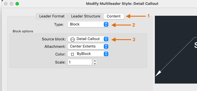

Create a Multileader Style
You can create your own multileader styles from the Leader panel, or by entering MLEADERSTYLE in the Command window.
For example, to create a "detail callout" style, start the MLEADERSTYLE command. In the Multileader Style Manager, click Add
and choose a descriptive name for the new multileader style. Click Content (1), choose Block (2), and then Detail Callout (3) as shown.
