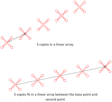

Array
Arranges a specified number of copies in a linear array.
Number of Items to Array
Specifies the number of items in the array, including the original selection set.
Second Point
Determines a distance and direction for the array relative to the base point. By default, the first copy in the array is positioned at the specified displacement. The remaining copies are positioned in a linear array beyond that point using the same incremental displacement.
Fit
Positions the final copy in the array at the specified displacement. The other copies are fit in a linear array between the original selection set and the final copy.
Fit
Redefines the array to use the specified displacement as the location of the last copy rather than the first copy, fitting the other copies between the original selection set and the final copy.
