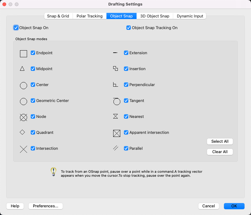

Object Snap Tab (Drafting Settings Dialog Box)
Controls running object snap settings.
DSETTINGS (Command)
Menu: Tools > Drafting Settings.
Note: The 3D Object Snap tab is not available in AutoCAD LT.

Object Snap On
With running object snaps, the object snaps selected under Object Snap Modes are active while specifying points on objects when a command is in progress. (OSMODE system variable)
Object Snap Tracking On
With object snap tracking, the cursor can track along alignment paths based on current object snap modes when specifying points in a command. (AUTOSNAP system variable)
Object Snap Modes
Lists object snaps that you can turn on as running object snaps.

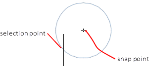

Center
Snaps to the center of an arc, circle, ellipse, or elliptical arc.

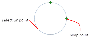

Quadrant
Snaps to a quadrant point of an arc, circle, ellipse, or elliptical arc.

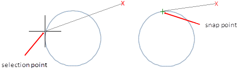

Perpendicular
Snaps to a point perpendicular to the selected geometric object.
Deferred Perpendicular snap mode is automatically turned on when the object you are drawing requires that you complete more than one perpendicular snap. You can use an object such as a line, arc, circle, polyline, ray, xline, multiline, or 3D solid edge as an object from which to draw a perpendicular line. You can use Deferred Perpendicular to draw perpendicular lines between such objects. When your cursor passes over a Deferred Perpendicular snap point, an AutoSnap tooltip and marker are displayed.
Tangent
Snaps to the tangent of an arc, circle, ellipse, elliptical arc, polyline arc, or spline.
Deferred Tangent snap mode is automatically turned on when the object you are drawing requires that you complete more than one tangent snap. You can use it to draw a line or xline that is tangent to arcs, polyline arcs, or circles. When your cursor passes over a Deferred Tangent snap point, a marker and an AutoSnap tooltip are displayed.
Note: When you use the From option in conjunction with the Tangent snap mode to draw objects other than lines from arcs or circles, the first point drawn is tangent to the arc or circle in relation to the last point selected in the drawing area.

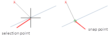

Nearest
Snaps to the nearest point on an object such as an arc, circle, ellipse, elliptical arc, line, point, polyline, ray, spline, or xline.

Select All
Turns on all running object snap modes.
Clear All
Turns off all running object snap modes.
