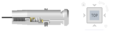

Roll a Face View
When you view a model from one of the face views, two roll arrow buttons are displayed near the ViewCube. Use the roll arrows to rotate the current view 90 degrees clockwise or counterclockwise around the center of the view.
Switch to an Adjacent Face
When the ViewCube is active while viewing a model from one of the face views, four orthogonal triangles are displayed near the ViewCube. You use these triangles to switch to one of the adjacent face views.
