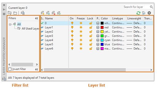

Layer List
Modify the layer properties using the layer list. Click the current setting to change the layer property for the selected layer or group of layers.
Note: The layer list can be filtered and sorted to make it easier to find and select the layers that you want to change.

Manage the Layer List
Search for Layer
Filters the layer list by name as you enter characters in the box.

Filters List
Displays the list of layer filters in the drawing. Click to expand or collapse the filter list. When the Filters list is collapsed, use the Layer Filter button () at the bottom-left corner of the Layer Properties Manager to display a list of filters.

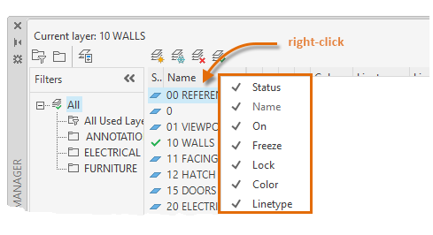

Column Label Shortcut Menu
Column Names
Lists all columns by name. A check mark indicates that the column is included in the display. Click a column name to display or hide the column. VP Freeze, VP Color, VP Linetype, VP Lineweight, and VP Plot Style are available only when a layout viewport is active.
Customize
Displays the Customize Layer Columns dialog box, where you can specify which columns are hidden or displayed, or change the column order.

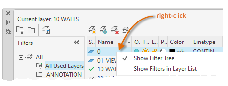

Layer List Shortcut Menu
Show Filter Tree
Displays the Filters list. Clear this option to hide the list. Same as .
Show Filters in Layer List
Displays layer filters at the top of the layer list. Clear this option to display only layers in the layer list.

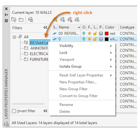

Filter List Shortcut Menu
Visibility
Changes the visibility of the layers in the selected filters.
Lock
Controls whether layers are locked or unlocked in the selected filters.
Viewport
In the current layout viewport, controls the VP Freeze setting of the layers in the selected filters.
Isolate Group
Freezes all layers that are not included in the selected filters.
  • All Viewports.
    • In all layout viewports, sets VP Freeze for all layers that are not included in the selected filters.

New Properties Filter
Displays the Layer Filter Properties dialog box. Same as .
New Group Filter
Creates a layer group filter. Same as .
Convert to Group Filter
Converts the selected layer property filter to a layer group filter.
Rename
Edits the selected layer filter name.
Delete
Removes the selected layer filter. You cannot delete the All, All Used Layers, or Xref layer filters.
Properties
Displays the Layer Filter Properties dialog box, where you can modify the definitions of the selected layer property filter. This option is available only when a layer property filter is selected.
Select Layers
Adds or replaces layers in the selected layer group filter. This option is available only when a layer group filter is selected.
  • Add. Adds layers to the selected layer group filter from the objects selected in the drawing.
  • Replace. Replaces the layers of the selected layer group filter with the layers of the objects that are selected in the drawing.
