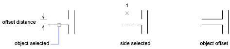

You can offset an object at a specified distance or through a point. After you offset objects, you can trim and extend them as an efficient method to create drawings containing many parallel lines and curves.

Offset Distance
Creates an object at a specified distance from an existing object.

Through
Creates an object passing through a specified point.
Note: For best results when you offset a polyline with corners, specify the through point near the midpoint of a line segment, not near a corner.
