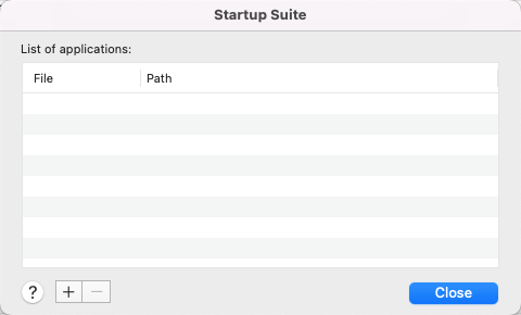

Startup Suite Dialog Box
Adds and removes application files from the Startup Suite. These are the applications that are loaded each time you start AutoCAD 2025
APPLOAD (Command)
Menu: Tools > Load Application: Startup Suite: Contents.
List of Options
The following options are displayed.
List of Applications
Displays an alphabetical list (by file name) of the application files to load at startup.
Add
Displays the Add File to Startup Suite dialog box. You can use this dialog box to select files to add to the startup suite.
Remove
Removes selected files from the Startup Suite.
