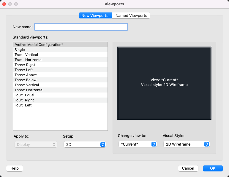

New Viewports Tab—Model Space (Viewports Dialog Box)
New Name
Specifies a name for the new model space viewport configuration. If you do not enter a name, the viewport configuration is applied but not saved. If a viewport configuration is not saved, it cannot be used in a layout.
Standard Viewports
Lists and sets the standard viewport configurations, including CURRENT, which is the current configuration.
Preview
Displays a preview of the viewport configuration you select and the default views assigned to each individual viewport in the configuration.
Apply To
Applies the model space viewport configuration to the entire display or to the current viewport.
  • Display: Applies the viewport configuration to the entire Model tab display.
  • Current Viewport: Applies the viewport configuration to the current viewport only.
Setup
Specifies either a 2D or a 3D setup. When you select 2D, the new viewport configuration is initially created with the current view in all of the viewports. When you select 3D, a set of standard orthogonal 3D views is applied to the viewports in the configuration.
Change View To
Replaces the view in the selected viewport with the view you select from the list. You can choose a named view, or if you have selected 3D setup, you can select from the list of standard views. Use the Preview area to see the choices.
Visual Style
Applies a visual style to the viewport. All available visual styles are displayed.

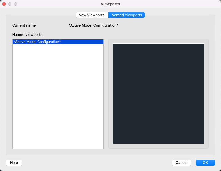

Named Viewports Tab—Model Space (Viewports Dialog Box)
Lists all saved model viewport configurations in the drawing.
Current Name
Displays the name of the current viewport configuration.
