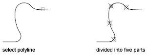

Select Object to Divide
Specifies a single geometric object such as a line, polyline, arc, circle, ellipse, or spline.
Number of Segments
Places point objects at equal intervals along the selected objects.

The illustration shows an arc divided into five equal parts using a block consisting of a vertically oriented ellipse.
