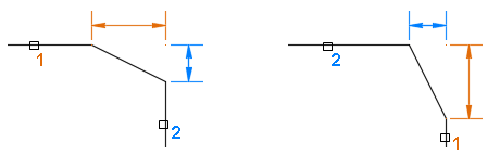

Create a Chamfer Defined by a Length and an Angle
The size of the chamfer is defined by a length and an angle. The length value defines the first side of the chamfer from the intersection of the two selected objects or adjacent 2D polyline segments, and the angle value defines the second side of the chamfer.

Create a Chamfer Defined by Two Distances
The size of the chamfer distance is defined by two length values. The length values define the first and second sides of the chamfer from the intersection of the two selected objects or adjacent 2D polyline segments.
