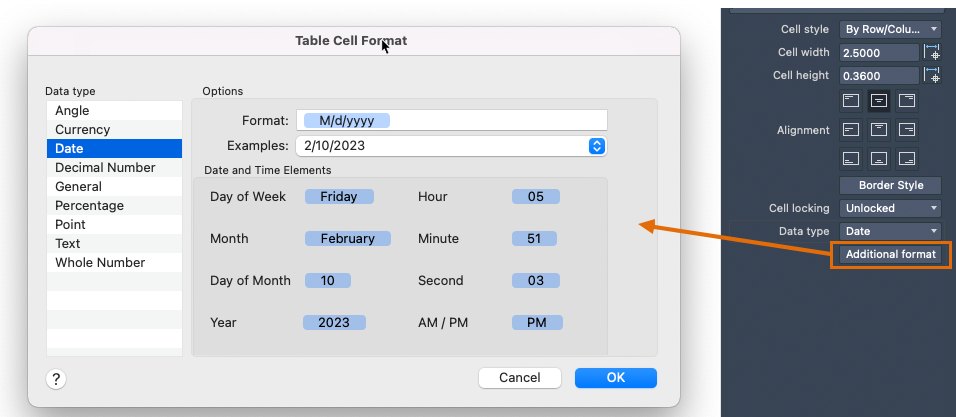

  3. On the Properties Inspector, select a data type from the drop-down menu.
    Different formatting options are shown depending on the data format selected.
  4. Define the format.
  5. If available, click Additional Format to display the Table Cell Format dialog box with more formatting options.
  6. Select from the available options.
  7. Click OK.
