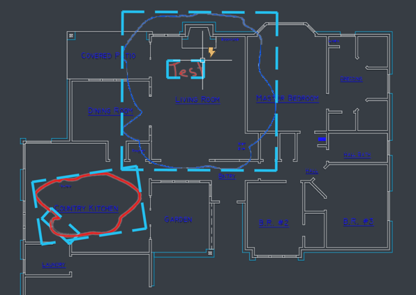

Markups can be imported as a PDF, PNG, or JPG and are overlaid on top of your drawing in the Trace workspace. Markups in the imported file are automatically identified as mtext, mleaders, and revision clouds. Markup Assist lets you insert those identified markups into the drawing as geometry.
Markup Import
Use Markup Import to place a marked-up version of your drawing on top of the original file to make it easier to view and incorporate changes to your drawing. For example, if you have a PDF version of your drawing that has text and revision notes added, use Markup Import to overlay the revised drawing on top of the original. Or, if you have a printed version of your drawing that contains hand-written revision notes, you can take a photograph of the printed version and then import it as a JPG or PNG.
The imported file is automatically placed and aligned on top the drawing file in a new trace.

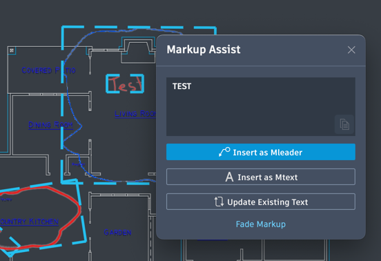

Markup Assist
Markup Assist automatically identifies markups as text, leaders, and revision clouds. Click an identified markup, then insert it as an mtext, mleader, or revcloud object. You can edit the text before inserting it, or choose to copy the text to the clipboard.

- Click the border on an identified markup.
- If the identified markup is text, choose to insert the object as mtext, as an mleader, or update existing text using the text string. You can edit the text before inserting it.
Inserting the object adds it to the drawing as geometry.

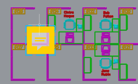

Markups With Associated PDF Text Comments
Text comments that are added to a PDF using Adobe software will display and can be inserted into the drawing as an Mleader or Mtext, or used to update existing text.
To insert text from a PDF text comment:
- Click the markup that contains a PDF text comment.
- Insert the text as an Mleader, Mtext, or Update Existing Text.

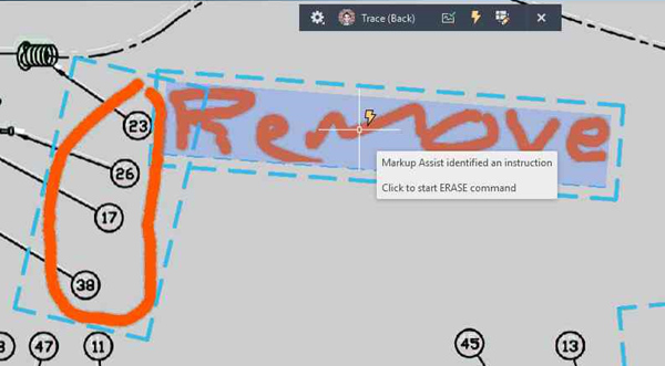

Instruction Text on a Markup
Markup Assist detects certain instructions in markup text that are linked to commands such as "MOVE," "COPY," or "DELETE." When Markup Assist identifies an instruction, you can click that instruction to start the associated command.
