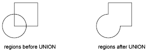

You can combine two or more 3D solids, surfaces, or 2D regions into a single, composite 3D solid, surface, or region. You must select the same type of objects to combine.

The selection set can contain objects that lie in any number of arbitrary planes. For mixed object types, selection sets are divided into subsets that are joined separately. Solids are grouped in the first subset. The first selected region and all subsequent coplanar regions are grouped in the second set, and so on.
The resulting composite solid includes the volume enclosed by all of the selected solids. Each of the resulting composite regions encloses the area of all regions in a subset.
