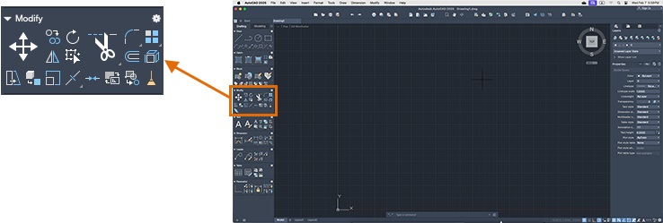

Perform operations such as erase, move, and trim on the objects in a drawing.
The most common of these tools are located on the Modify panel of the Drafting tab of the toolsets. Take a minute to look through them.

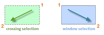

Select Multiple Objects
Sometimes you need to select a large number of objects. Instead of selecting each object individually, you can select the objects in an area by clicking an empty location (1), moving your cursor right or left, and then clicking a second time (2).
- With a crossing selection, any objects within or touching the green area are selected.
- With a window selection, only the objects completely contained within the blue area are selected.
The result is called the selection set, which is the set of objects that will be processed by a command.

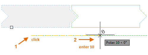

Here's how you would use the COPY command to lay out a row of decorative tiles. Starting with a polyline that represents its shape, you need to make copies that are 1/8" apart.
You click the Copy tool or enter CP in the Command window to start the command. From here, you can choose between two methods, depending on what's more convenient. You will use both these methods frequently.
The Distance Method
The second tile needs to be a total of 9-7/8" + 1/8" = 10" to the right of the original tile. So, you select the tile, press Enter or the Spacebar to end your selection, and click anywhere in the drawing area (1). This point does not have to be located on the tile.
Next, you move your cursor to the right, relying on the polar tracking angle to keep the direction horizontal, and then enter 10 for the distance. Press Enter or the Spacebar a second time to end the command.
The specified distance and a direction from the point (1) is applied to the tile that you selected.

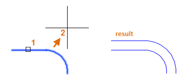

Offset
Most models include a lot of parallel lines and curves. Creating them is easy and efficient with the OFFSET command. Click the OFFSET tool or enter O in the Command window.
Select the object (1), specify the offset distance, and click to indicate on which side of the original that you want the result (2). Here is an example of offsetting a polyline.

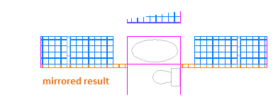

Mirror

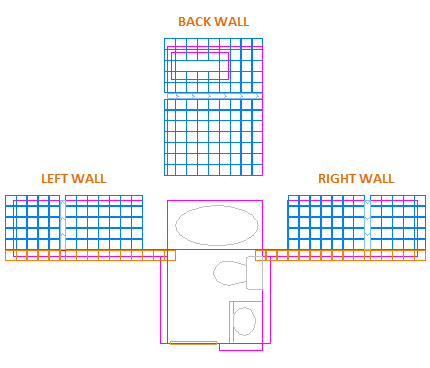

The following illustration comes from a tile project. The walls in this residential bathroom are flattened out to be able to lay out the tile pattern and estimate the number of tiles needed.
You can save a lot of work by taking advantage of the symmetry between the left and right walls. All you need to do is create the tiles on one wall and then mirror the wall across the center of the room.
In the example below, you start the MIRROR command ( or enter MI in the Command window), use window selection (1 and 2) to select the geometry on the right wall, press Enter or the Spacebar, and then specify a mirror line (3 and 4) corresponding to the centerline of the bathroom.
Finally, decline the option to "Erase source objects" by pressing Enter or the Spacebar.

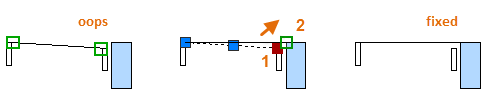

Grips
Grips are displayed when you select an object without starting a command. Grips are often handy for light editing. For example, the line below accidentally snapped to the wrong endpoint. You can select the misaligned line, click on a grip and then click to specify the correct location.
By default, when you click a grip, you automatically start in **STRETCH** mode as indicated in the Command window. If you want to explore other ways of editing objects with grips, press Enter or the Spacebar to cycle through several other editing modes. Some people perform most editing operations using grips.
