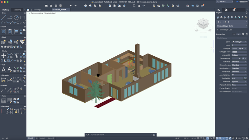

3D Graphics: Below is a list of improvements that have been made to the Shaded (Fast) and Shaded with Edges (Fast) visual styles.
- Selection (Fence, Lasso, Polygon)
- Paper space support
- TrueType font support
- Line weights
- Locked layer dimming
- Xref dimming
- General stability, visual fidelity, and performance improvements
