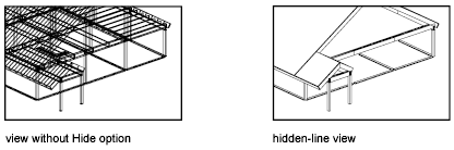

The illustration below was created with lines that were extruded by giving them a nonzero thickness.

For viewing, you can temporarily suppress hidden lines with HIDE.
HIDE suppresses all hidden lines in a view. When the view is regenerated, all objects are displayed normally.
