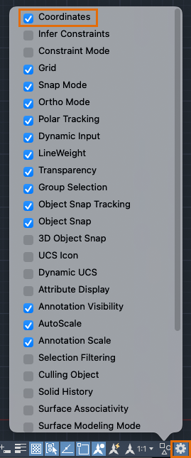

    Use one of the following methods:
  • At any prompt for a point, click the coordinate display located on the left end of the status bar ( Find).
  • Press Ctrl + i repeatedly.
  • Set the COORDS system variable to 0 for static display, 1 for dynamic display, or 2 for distance and angle display.
Note: If coordinates are not displayed on the status bar, select Coordinates from the status bar settings.
