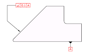

Creates geometric tolerances contained in a feature control frame.
Access Methods
Tool Sets: Drafting tab > Dimension panel > Tolerance.
Menu: Dimension > Tolerance.
Summary
The Geometric Tolerance dialog box is displayed.
Geometric tolerances show acceptable deviations of form, profile, orientation, location, and runout. Feature control frames can be created with leader lines using TOLERANCE, LEADER, or QLEADER.
