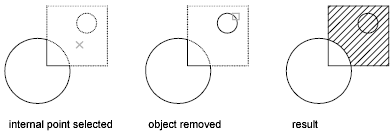

Add: Pick Points
Determines a boundary from existing objects that form an enclosed area around the specified point.
If you turn on Island Detection, objects that enclose areas within the outermost boundary are detected as islands. How HATCH detects objects using this option depends on which island detection method is specified.
Add: Select Objects
Determines a boundary from selected objects that form an enclosed area.
Interior objects are not automatically detected. You must select the objects within the selected boundary to hatch or fill those objects according to the current island detection style.
Each time you click Add: Select Objects, HATCH clears the previous selection set.
Remove Boundaries
Removes from the boundary definition any of the objects that were added previously.
